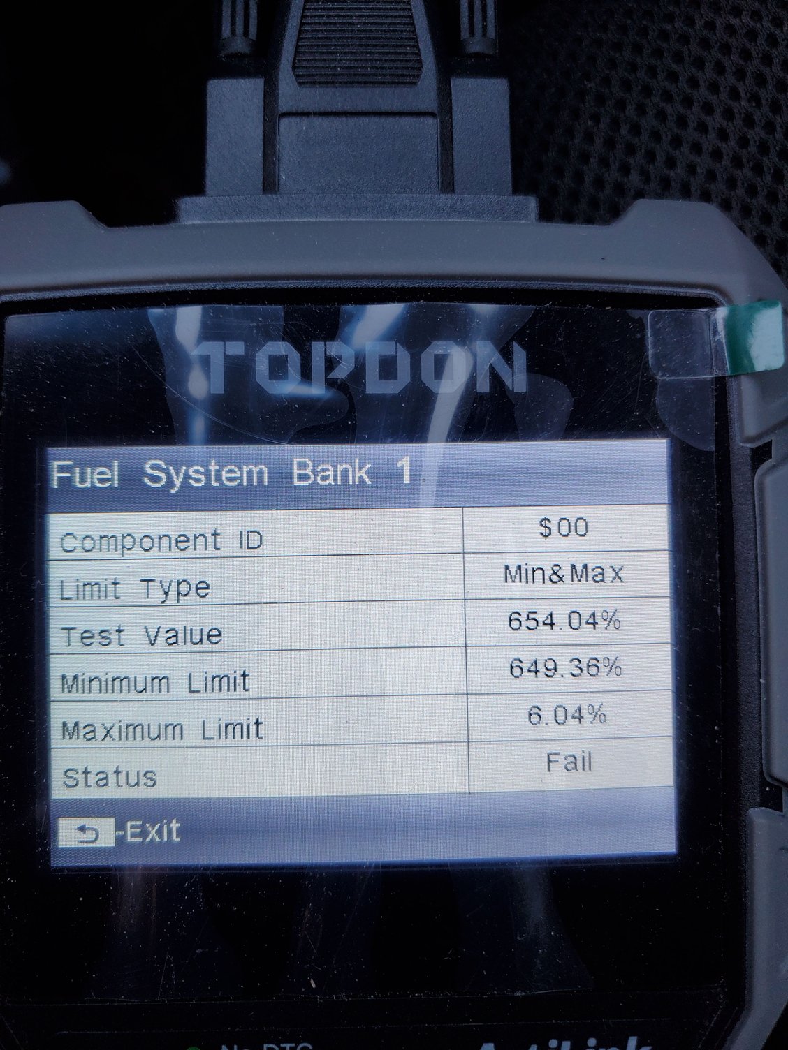

While checking out my new code reader, I found a section that shows a bunch of test results. Every test was passed, except these 2.
June 21
And again today July 6

I don't know what the fuel system thing is. Got a number?
I don't understand how there are "fails" without DTC. So why can't get smogged? What does I/M readiness say?

Purge says component ID $0c, fuel says $00, does that mean anything to you?

purge valve is open. I think those numbers are PWM cylcloes.
The $00 and $0C are addresses on the CANbus

Can those addresses be translated to components?
