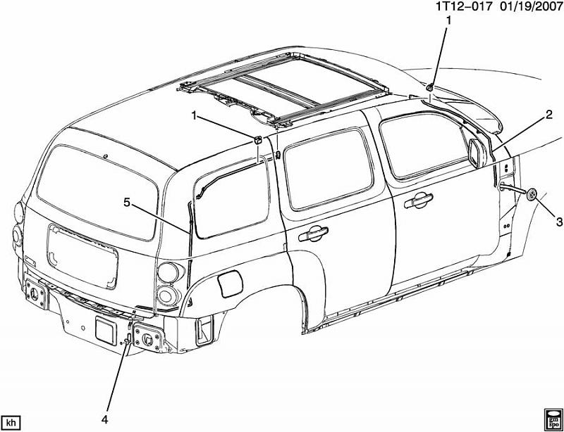

Best I can do is show a picture. The drain tube is inside the car until it reaches the exit point. Could be leaking from the tube somewhere.
2nd thing to check would be the rubber grommet where the wiring harness passes thru from the A-pillar to the door.
FYI. There are similar tubes for the left side of the car. They just aren't in this picture.

Oh yeah, I've seen this picture in the threads before. That's how I knew it might be related to the drain. My question was mostly thst since I witnessed the dripping coming from there, is it probably the drain and not the butyl patch this time? Just so we don't waste time.

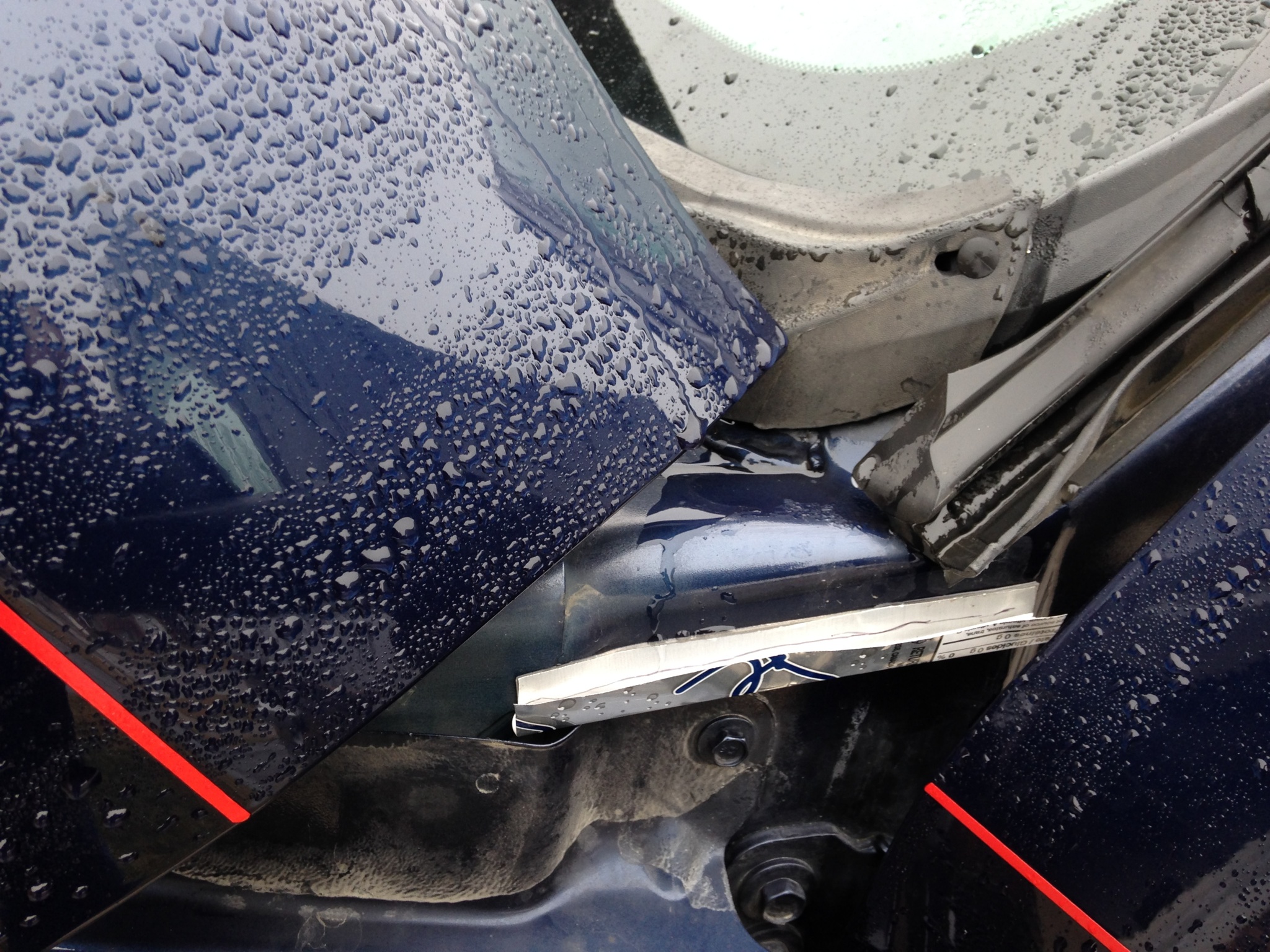

I troughed the water away from the grommets, mostly to stop ice forming in the hinge area
