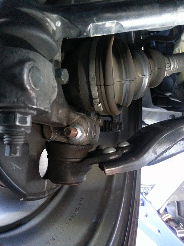

The ball joint dust cover shows cracks.

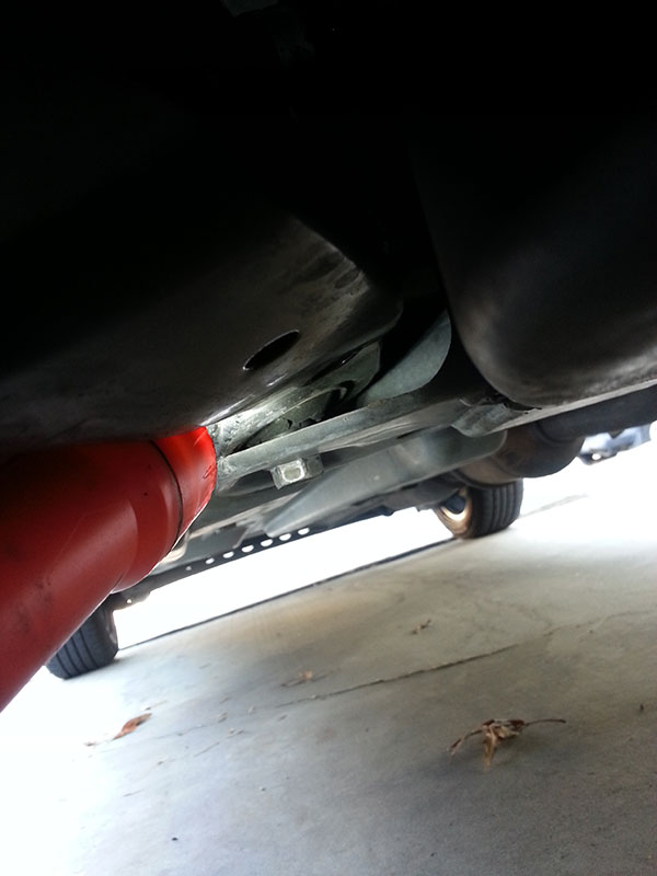

LCA bushing is cracked too! Is it supposed to be angled like this?! I thought is supposed to be flush with the metal plate at the bottom.

Side note: the pictures you posted look normal to me, you are forgetting that the suspension moves and the parts are unloaded while taking the pictures. The purpose of the bushing is to allow the arm to move in relation to the anchor point.
