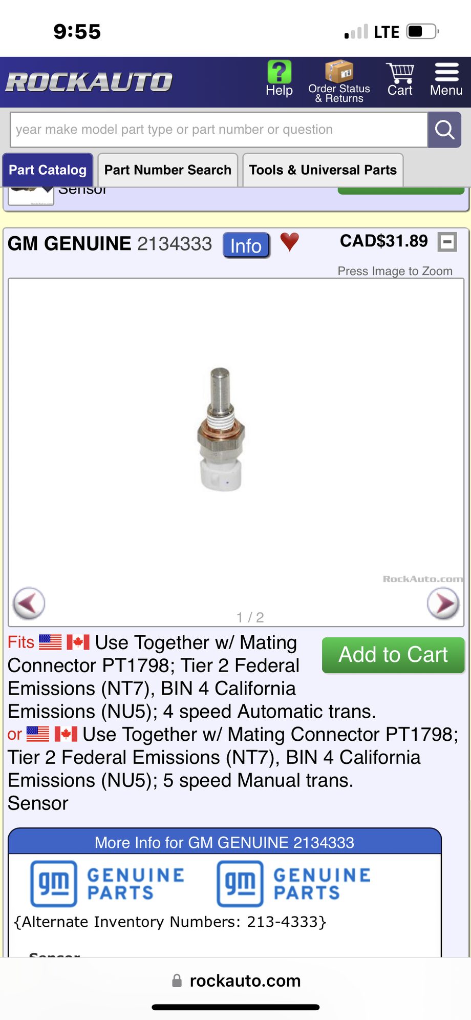

Edit: I’m at the shop right now. Ended up being the coolant temp sensor. It was reading that the vehicle was 8 degrees. Everything else appears to be okay he said. So all in all it’s going to cost $150 for parts and labor and he’s doing it right now.

Not leaking, overheating boil over.
Old Jun 7, 2023 | 08:13 AM
Posts: 40,096
If you’re handy there’s only 2 bolts! 10mm wrench will do it!
will update when the job is done and let you guys know how the cars running
Old Jun 7, 2023 | 08:57 AM
Posts: 40,096
Wow, 1 connection and a 19 mm deep socket to change the part and maybe a pint of coolant.
