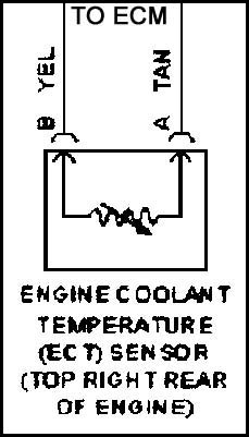

The temp sensor in located at the top right rear of the engine, it is basically a rheostat that varies in resistance based on the temp of the engine/coolant, it connects to the ECM, I believe my thermostat opens at about 180 degrees, thermostat's are available at higher and lower temp operation, but it is wise to adhere to what GM recommends.
