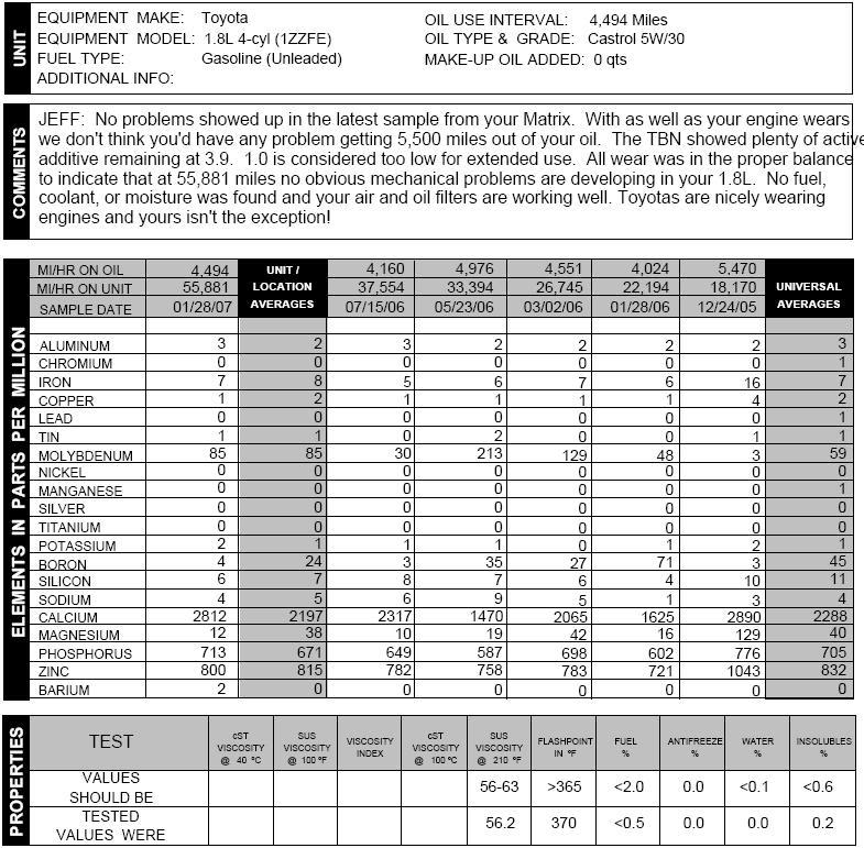

I think changing the filter out at 3K is too early. Did you mean Durablend? If so that is the synthetic blend. SynPower is the straight synthetic oil from Valvoline. You should be able to run that filter out until 6-7K miles easy. Have your oil analyzed at Blackstone Labs and they will provide with all the info you need to know on how you oil is doing, how well filtration is taking place etc....well not the end all and absolute truth it will give you a pretty good idea on how things are going under the hood. Here is a report I got with my Matrix
Cost is 32.50 per sample or 22.50 without having a TBN done. TBN basically gives you a number on how much longer you could have run the oil
