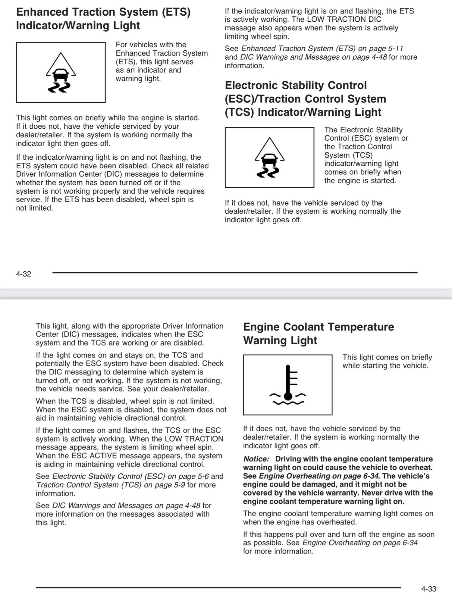

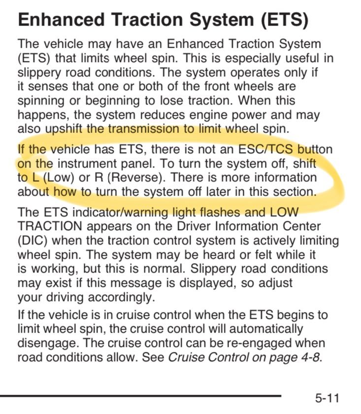

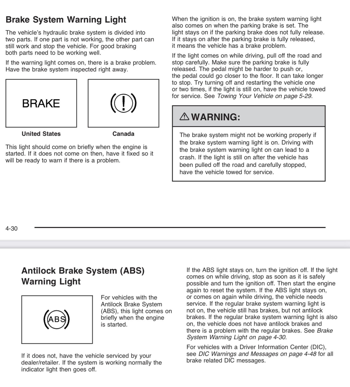

My 2010 Owners Manual (electronic) doesn’t have page numbers like you listed. Mine shows sections and pages like 4-72, 5-16 etc.
Could you post up page #’s like that ?
Sorry about that oversight. I guess the page numbers are only on the PDF, and prolly even vary with the reader. Will go back and fix. Might take a minute. For anyone who can’t wait, I got to the first page with the table of contents, and just followed the provided breadcrumbs.
EDIT - Corrections made. Here are a few pages, for convenience.

The 2010 Owner Manual has no such page numbers and does not have any procedure for resetting the TC/ESC other than pushing the button.
Page number issue is being fixed. The manual does state to simply turn off the ignition to reset a persistent ESC warning. It also states that some cars with ETS have no such button.
