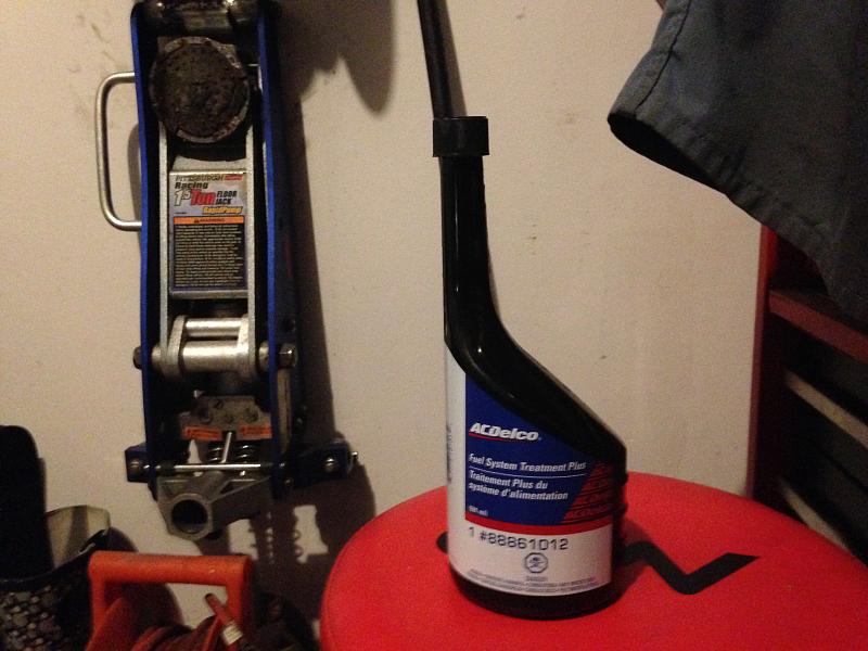

Try GM fuel system treatment plus #88861012!

Just took it to the shop. Cylinders 1-3 are roughly 150psi. Cylinder 4 is 90. No estimate given, this shop doesn't do internal engine work. Looks like it was worst case scenario.
