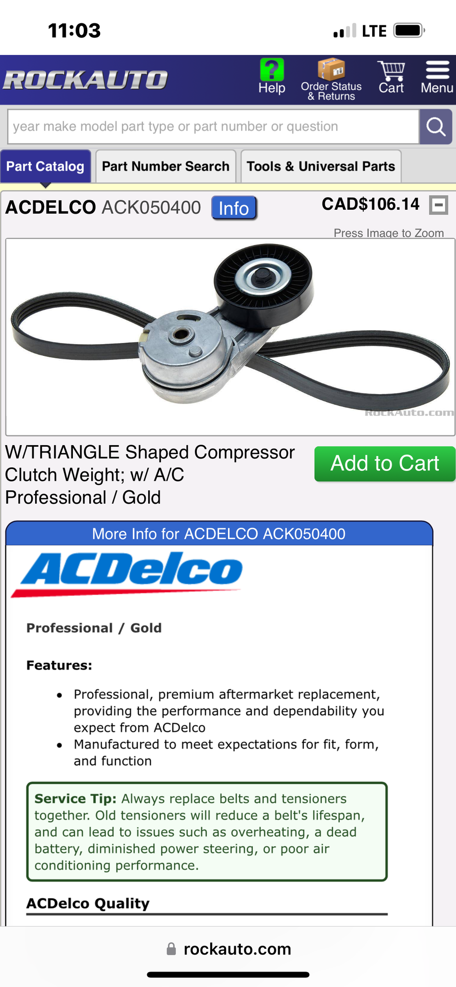

So I've been thinking about replacing my serpentine belt since it's coming up on the 100k mile mark, but when browsing rockauto I notice there are "multiple" versions of OEM belt from ACDelco
Which one is correct?
Old May 15, 2024 | 10:02 AM
Posts: 40,083
If your AC clutch is triangle shaped
https://www.rockauto.com/en/catalog/...ensioner,11659
I always replace the tensioner and idler pulley as a set, pay for what you get. That pulley will fail and so will the tensioner spring.
