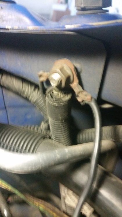

Originally Posted by Oldblue
Should be a single wire to the connection on the fuse box
That one up there on the left
tighten these 4 bolts they are 7 mm so use a 6 point 1/4” drive socket
Done already.
I understand the ground is screwed into the transmission casing?
Old May 14, 2026 | 12:02 PM
Posts: 40,045
Yes there’s one there and one on the rad cradle and several other places
Any details on where to find them? Chevy just washed their hands of the problem. I pick up the car tomorrow.
Old May 14, 2026 | 03:26 PM
Posts: 40,045
Here’s the one on the rad cradle , look on the drivers side of the engine bay above the headlight. The other end is on the transmission housing just down to the right of the oil filter cap.
