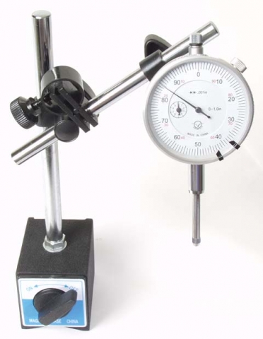

What a long read. I just went through this entire thread. Being that this '07 HHR is the newest car I've driven in a long time, I would like to know how to check the hub bearing end play. I am looking everywhere for something that shows how exactly to determine if the hub bearings have too much play, but am simply finding nothing apart from just stupidly trying to wiggle the wheel. How exactly do you do this?

As far as I can figure, using a run out gauge to check for ANY sloppiness, or listen for the roar of bad bearings. I asked the same question a while ago and that was the roundabout consensus. Since they are ball bearings not rollers "end play" as we dinosaurs know it does not exactly apply.

Ok, I must admit that I don't even know what a "run out gauge" is, nor have I ever used one. Yes, I am displaying my ignorance here.

Run out gauges are really old school too and have been around for years. Just in the past few people had them since hub play was not as critical and but also it was needed to kick the brake pads back.
Today with the new brakes and hubs the calipers pull the pads back so they do not ride on the rotor or create any drag. The truth if a hub has enough play to feel it may be too much. The Run Out gauge is really like a dial indicator that measures movement. The generally accepted play on most [not I did not say all] is .001 to .002. It is best to check the spec with a dealer for manual based on what you are working on as it can vary.

I've just spent a good bit of time hunting around online for exactly how to do this. The gist I get is that you somehow mount the gauge, put it up against the hub assembly, and just rotate the assembly and read the gauge.

Ok, Magnetic base Dial Indicator: You mount it on a piece of steel (that won't move) & adjust the dial needle to the rotor wear surface, Zero out the gage & slowly turn the rotor, while watching the run-out on the gage..

Thank you. I'm going to pick up one of those gauges. The one you pictured looks to me to be a Grizzly G9849 Dial Indicator, and is only about $30 shipped.

The indicator has to mount on a part of the spindle like the brake caliper mount, not the brake caliper. You would also try to pull the rotor toward the indicator and push it away to check for bearing play.
