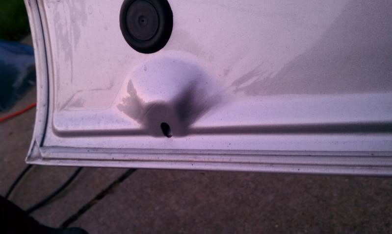

Find one that looks like this.

That's the one with the sealer.......
So they just cover the rust up so you can't see it?
