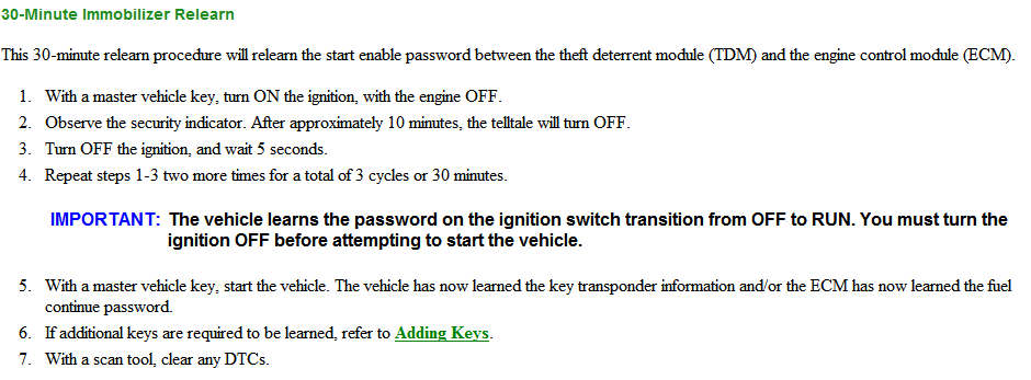

Tried the 30 min key learn but light stayed on and the padlock symbol stayed locked.

Is this the procedure you used?
There is a 10 minute learn procedure that requires a Tech2 or the like.

The 10 min learn... Indicator NEVER went out.
