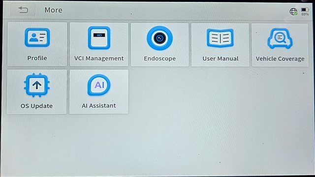

Here's a screenshot of ALL of the Special Functions that this tool is capable of, many of which do NOT apply to the HHR.
