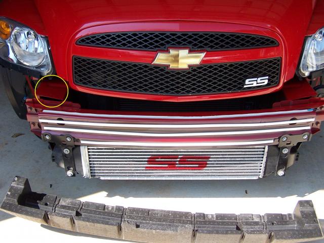

Sorry to say this but it sounds like you've damaged the intercooler. Most likely cracked the plastic end tank.
The wastegate is located behind the engine, up high on the exhaust near the firewall. Doubt that has anything to do with your problem.
Old Nov 18, 2015 | 05:12 PM
Posts: 11,721
Found one of my old pictures that shows the intercooler. The silver part is metal but the black ends(under those brackets) are plastic and can get broken.

George, you are absolutely right. After reading your post all I had to do was raise the hood, look down at the IC, and I saw the bigass crack in the black plastic end piece. Since I have to replace the intercooler anyway, I should probably check out an aftermarket unit that may be a little more durable and possibly more efficient as well. Anybody recommend a decent one at a reasonable price?

You can get one from ZZP. Not sure how out fairs with the factory charge tubes. I had to modify the mounting brackets and locations to it to fit correctly. Good product though. I'd like to take a broken factory and weld in aluminum ends. What would you want for the busted one? I actually have another stock IC in the garage I'm not using at the moment. I'm also driving through new York on my way to Hamilton, Ontario. I'll be coming back through Sunday and I leave tonight. Let me know.
@FMG- did you paint the SS on the IC? If so, is there any trick or special paint to it? I would love to do that to the wifes. It was suppose to have the ZZP emblem but it came without. The SS would look much better anyways.
