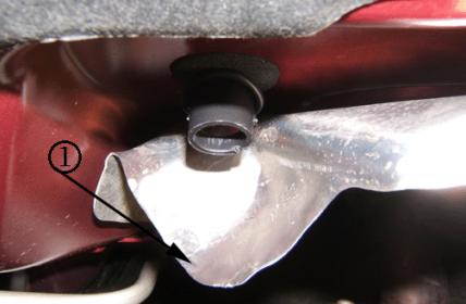

09-01-37-002a
#09-01-37-002A: Front and Rear Passenger Floor Carpet Wet (Inspect White Plug in HVAC Evaporator Drain and Apply Sealer to Front of Dash Area) - (Nov 3, 2009)
Subject: Front and Rear Passenger Floor Carpet Wet (Inspect White Plug in HVAC Evaporator Drain and Apply Sealer to Front of Dash Area)
Models: 2008-2010 Chevrolet Cobalt, HHR, Malibu
2008-2009 Pontiac G6
2008-2009 Saturn AURA
Condition
Some customers may comment that the front and rear floor carpet is wet on the passenger side.
Cause
This condition may be caused by a plugged HVAC evaporator Drain. In some cases, water from the HVAC system will drain back though the front of the dash.
Correction
Note: Reposition of the heat shield is not necessary on a Cobalt and HHR.
1. Verify the customer's concern. If there is water on the passenger side front floor area, raise and suitably support the vehicle. Refer to Lifting and Jacking the Vehicle in SI.
2. Inspect the operation of the drain.
Note: Make sure that small debris is not plugging up the drain.
3. Reposition the heat shield (1) in order to gain access to the HVAC drain.
4. Remove the white plug (1) and assure there is no debris in the drain tube and/or plug. If debris exists, pull from the drain tube (do NOT force back into evaporator case) and reinstall the plug.
Important: Do not get sealer on the heat shield, on the end of, or within the drain tube.
5. Mask off the areas (1, 2) by the HVAC drain using high-quality automotive tape.
6. Apply high tech seam sealer, Kent Industries P/N P6101*, to the front of dash area as shown in figure below.
7. Remove the high quality automotive tape and reposition the heat shield to it's normal position.
8. Lower the vehicle. Let the vehicle run with A/C on.
Perform a final inspection for the A/C and verify that the system is draining properly.
* We believe this source and their products to be reliable. There may be additional manufacturers of such products/materials. General Motors does not endorse, indicate any preference for, or assume any responsibility for the products or material from this firm or for any such items that may be available from other sources.
Condition
Cause
Correction

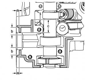

Remove the fuel pump. Refer to Fuel Pump Removal in SI.
Remove the camshaft cover. Refer to Camshaft Cover Removal in SI.
Remove the camshaft cap (1). Remove all excess sealing material from both surfaces.
Note: It is critical during installation to ensure the bearing rear cap and cylinder head alignment is correct and the mating surfaces are flush.
• Ensure that all sealing material has been removed from the components and the sealing surfaces are clean and free of contamination prior to applying the sealer.
• Install and align the rear cap within 20 minutes of applying the sealer.
Apply a 2.5 mm (0.1 in) bead of sealer, GM P/N 12378521 (in Canada, use P/N 88901148) to the cylinder head at the number 6 intake camshaft rear cap mating surface.
Note: Apply the sealer to all locations centrally locating the bead on the rail.
• Run the bead to 5 mm (0.2 in), dimension "a", as shown.
• Where the cap ends on the perimeter rail, extend bead approximately 4 mm (0.2 in) beyond edge of cap.
• Run bead, dimension "c", 32 mm (1.3 in) from the edge of the cylinder head as shown.
• Run bead, dimension "b", 20 mm (0.8 in) from edge of cylinder head as shown.
Install the number 6 intake camshaft rear cap.
6.1. Tighten the cap bolts evenly to 5 N·m(44 lb in).
6.2. Tighten the cap bolts evenly to 10 N·m(89 lb in).
6.3. Back the cap bolts out 120 degrees.
6.4. Tighten the cap bolts evenly a final pass to 10 N·m(89 lb in).
