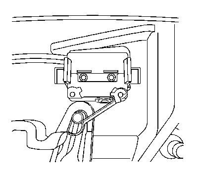

#PI0021B: Instrument Panel (IP) Center or Outer Air Outlet (Vanes) Broken or Inoperative - (Oct 27, 2010)
Subject: Instrument Panel (IP) Center or Outer Air Outlet (Vanes) Broken or Inoperative
Models: 2006-2011 Chevrolet HHR
This PI is being revised to add the 2011 model year, update the repair information and add Parts Information. Please discard PI0021A.
Condition/Concern
Some customers may comment that one of the center or outer IP air outlet vanes is broken or inoperative.
Various customer use situations may cause an over-rotation of the center or outer IP air outlets, which can damage the vanes (1) or their connecting mechanism.
Recommendation/InstructionsThe air outlet vanes are now released as a service component separate from the air outlet assembly. For any affected air outlet location, order the part number listed in the part table below and replace the vanes following the steps below:
Starting with the smaller vane (without the thumb impression), remove the vane from the assembly by inserting a small flat-bladed screwdriver (1) between the outer edge of the vane and the flat sidewall of the retainer.
Carefully push the retainer wall outboard, away from the vane, while pulling the vane forward to disengage the end retaining pin from the wall.
With the small vane pin released, use the screwdriver to disengage the larger vane retaining pin on the same side.
Once the pins on one side are free, pull the vane toward the free side and use the screwdriver to release the opposite side pins and remove the vanes from the assembly.
Note: When installing the new vanes into the air outlet assembly, ensure that the smaller vane is installed into the hole (1) closest to the end of the retainer wall, and the large vane is installed into the hole (2) further from the end. The air outlet assembly, in the graphic above, is shown removed from the vehicle for illustration purposes.
Install the large and small vane retaining pins into the proper holes on one side of the assembly.
Use the screwdriver to carefully push the retainer wall outboard and install the retaining pins on the opposite side.
Verify proper function of the air outlet.

#PI0011: Door Latch Diagnosis Procedure - (Dec 15, 2009)
Subject: Door Latch Diagnostic Procedure
Models: 2010 and Prior Passenger Cars and Trucks (Including Saturn)
2010 and Prior HUMMER H2, H3
2009 and Prior Saab 9-7X
Condition/Concern
Some customers may comment that the front or rear side door has one or more of the following conditions:
• The door will not open from the inside or outside handle.
• The door will not unlock with the key fob or electrical switch on the interior door trim.
• The door will not unlock with the inside lock knob.
• The door will not unlock with the key cylinder.
The primary cause of these symptoms is a condition called "preload," resulting from incorrect attachment of the outside handle rod to the latch. If the outside handle release lever on the latch is not in the full up position when the rod is attached by the clip on the latch, the latch will not operate correctly.
Another condition causing latch malfunction, especially lock/unlock, is caused by high effort on the inside lock knob. Resistance to the travel of the lock knob may cause the latch not to unlock.
A third condition causing malfunction is the improper or incomplete attachment of the outside handle rod and inside handle rod/cable. If the outside handle rod clip is not completely secured, the clip can come unlatched and the outside handle will not function.
The following diagnosis might be helpful if the vehicle exhibits the symptom(s) described above.
Note: Verify the latching function after each step. If the condition exhibited is resolved without completing every step, the remaining steps do not need to be performed.
Perform these preliminary inspections:
Inspect the inside and outside door handle for debris, that all parts are present and working properly, and that they are securely attached.
Inspect the inside lock knob for smooth, low effort functioning manually and full travel with power locks. If high effort and/or partial travel are present, inspect for interference with the following components:
• the trim pad
• the inside lock knob rod grommet
• the side impact foam
• the water deflector
• the inner belt seal
• the wire harness
• other parts in the rod environment
For rear doors on which the inside handle will not function, verify that the child security feature is not engaged.
If no issues were found when performing the preliminary inspections, proceed with the following steps.
Remove the door trim while maintaining the inside handle cable attachment. DO NOT LET THE TRIM PAD HANG FROM THE HANDLE CABLE OR THE WIRE HARNESS.
Inspect the connections of the inside handle cable to the inside handle and latch. Assure that the cable is not kinked and that the lever on the latch moves when the inside handle is actuated. If the condition persists at this point, disconnect the inside handle cable from the handle and set aside the trim.
Verify that the key cylinder rod is attached to the key cylinder pawl and the latch. Reattach as required.
Verify that the outside handle rod is present, properly attached to the handle and is the correct part.
Unlatch the clip holding the outside handle rod to the latch. Make sure the outside handle rod lever on the latch is in the full up position and hard against stop on the latch. While maintaining this lever position, re-attach the rod using the clip. Pull on the bottom of the rod fore/aft and cross-car to assure secure attachment.
Verify that the electrical connector to the latch is fully seated. Remove and inspect for corrosion and electrical output when actuating the electrical switch on the door trim. If power is lacking, perform electrical diagnostics. Reconnect and assure that the connector is fully seated.
Unbolt the latch and remove the latch from the door cavity with the electrical connector still attached. Function the power locks using the switch on the door trim (reattach the switch module to the electrical harness.) Verify that the lock/unlock lever shows full travel (refer to the green arrow in the picture above). If the latch properly functions (DO NOT replace latch), properly reassemble in order to correct the bind/attachment issue.
