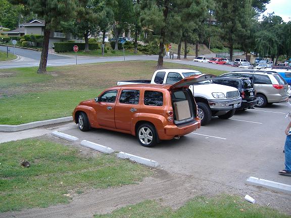

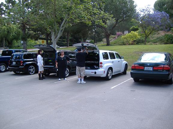

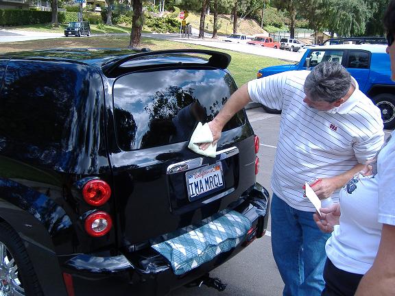

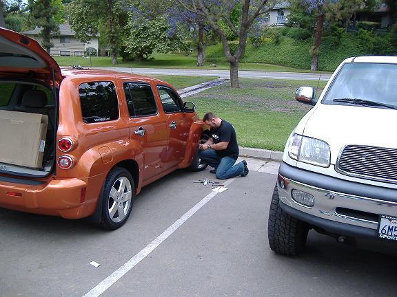

A few pics, Jason and Kim with the mud flaps and wiper removel

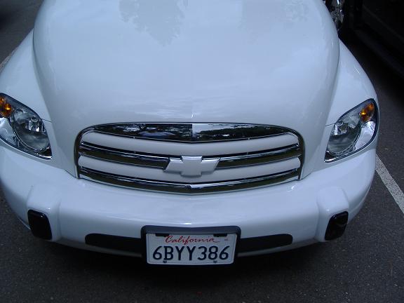

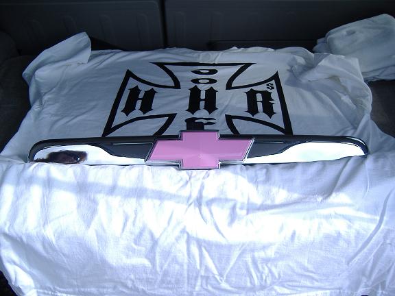

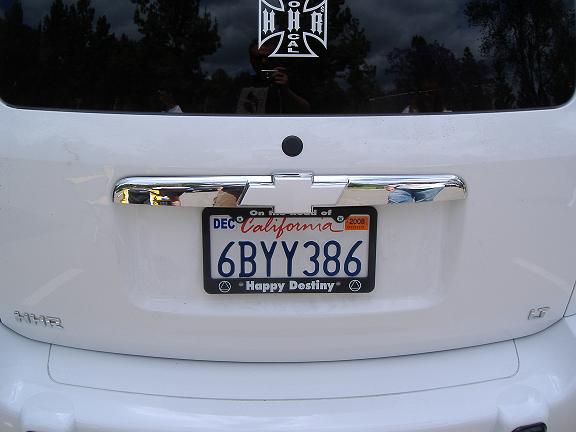

A couple pics of Don's wiper removel, new grille and beauty bar.

Angie, those pink bowties HAVE to go on.

Todd you have done it again!
Todd aka Grille-master
