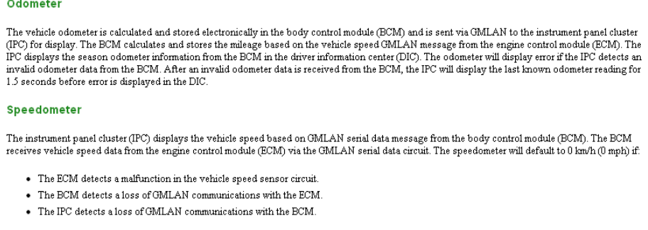

I did the F40 swap last summer. A question I've had that would be helpful here: Is there any way to recalibrate the ODOMETER? I didn't realize that recalibrating the speedometer didn't also cover the odometer. Any way to accomplish this?
Old Feb 26, 2023 | 09:14 PM
Posts: 26,533
You need a Tech2 or similar and the know-how to do it. Basically lie about the tires on the placard. Whoever did the speedo should know how to do the Odo.

I had ZZP do the speedo, they don't do odometer. Gave me a name to try, but they didn't do it either. Any specific suggestions? I'm in the Chicagoland area.

I'm not sure how adjusting the speedo doesn't adjust the odo. As far as I can figger they are both based on tire circumference and output shaft speed sensor.
How do you know the odo is not correct?

The speedometer is within a MPH of GPS speed. The odometer reads about 1 mile per 5 miles driven - not even close!

I may be totally wrong but I think the only adjustment in the computers is the tire placard. I know that you can adjust that when you use different size tires than came from the factory. When I used 215 55 instead of 215 50 the speedo was off by about 3 MPH and the odo about the same percent. I guess, I'm saying "you gotta find someone that knows how to program OBD2 computers"; no one here I know of.
They must have adjusted the odo to make the speedo correct. That seems illegal to me.
Here is how they work:
