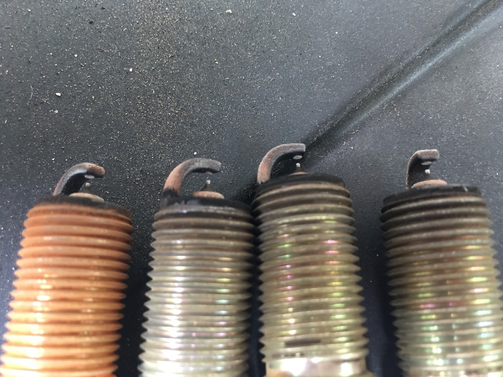

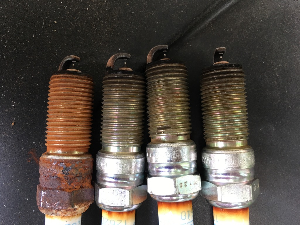

Plugs looked good and had consistent appearance across all four cylinders, no signs of coolant entering the combustion chamber and no oil fouling. Plug 1 did have some serious rust going on though but it was just the threads and nut which makes me think the hole got some water in it when someone tried to wash the engine or something. I have no idea how old these plugs are but Ive had the car for the last 40k miles and never replaced them.
Plugs pictured are cylinders 1-4 left to right.

Donbrew, I thought what you said as well as soon as I saw the rust. But hold on a sec...
1. The color of dexcool has nothing to do with the rust. Sure, both orange, but so what?
2. If steam is escaping through all those threads then why aren't combustion gases? This looks more like failure of the protective coating on the plug followed by Aluminum/steel corrosion to me.
3. The plug didn't look steam cleaned.
4. No evidence of coolant combustion at cold start.
5. No coolant smell in the engine bay while idling or after running.
6 No bubbling is visible on the upper radiator hose fill point while running at temp.
I think the spark plug corrosion is just a coincidence. Easy enough to test though as I should see the same corrosion within 50-100 miles of driving since that's about what I've done since this happened Saturday. I'm not saying that I don't need some sort of work done, I'm just not convinced that it's a head gasket yet.

I'm tending to agree with don also. Cylinder #1 is a little low compression, and also has the discolored plug. Just because your oil and coolant haven't mixed, you may still have a tiny head gasket leak. Coolant into the combustion chamber, but not into the crankcase. Good news for your rings.
Your slight loss of coolant in the recovery tank speaks to this also.

OK. Don't believe me. I tried.
After you take the head off you will find a fault between cyl #1 & cyl #2. You will identify it by the orange streak.
Now removing my Carnac the Magnificent turban.
