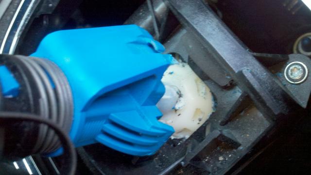

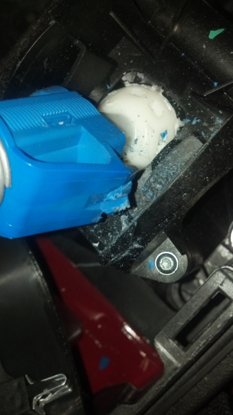

Ever since I got my car in late October, I always thought the shifting was a little weird. I would miss shifts just trying to get into fifth and I had a rough time just pushing it up in to place. Figuring it was just weather related considering I have been putting most of the miles on in the dead of a Michigan winter, I ignored it and tried warming it up a bit (shifting more). The other day I decided to take a look at the shifter my removing the plastic around it. I didnt want to remove the shifter boot because I read about how hard it was. Here's what I found and hopefully my pictures work...
To remedy the situation, I grabbed an exacto blade and a pair of wire cutter pliers and cut that tag off that was interfering with my shifting. Filed it down a bit to make it smooth and vaccuumed the blue dust up, put a little grease on it and its as smooth as ever!
Problem solved.
Anyways, if you feel like shifting is a little goofy, take the time check this out. No idea what caused it but an easy enough fix.
To access this area without disassembling your whole shifter, just remove the silver change pocket by pulling, remove the two bolts revealed (careful because the "nuts" they go to are just clamps and can slide off), then pull up on the plastic that surrounds the entire shifter assembly.

glad im not the only one. can anyone think of a cause for this? I didnt see something that could do this much damage

Agreed - there must be a cause. The pics on this thread and others look very similar - debris, cracking, looseness etc. Like a mad rat or child with a hammer got to it. A cheap assembly is obviously one factor (it even looks cheap GM) - which is very dangerous to us all. I cannot tell you how many times I have struggled to get in gear with engine and rear drivers both going beserk. So when dealers write "Cannot duplicate problem" on this, that means a couple test miles, but no lookee see? My work order does not indicate it was checked - and I specifically mentioned feeling jaggedness and sharpness while struggling. I want to take a lookee see before it goes in and take photos for myself and to share. How easy is it to access? Best tool to open it open without causing damage?

Looking at the 2 pictures above, I don't see any grease or lube.
Could that be the cause?
there was "some" on the knuckle but the part causing all the interference should not have had grease on it. it was some sort of tag on the side of the blue part that got worn away and mangled.

Mine had grease but the main cause is not pulling up the shifter to go in reverse. You can pop it in without doing that but itll cause shavings. Now that i have been the only driver, i dont have stuff in mine. But then i have had like three new shifters installed in 25k miles due to cords breaking. Lol
