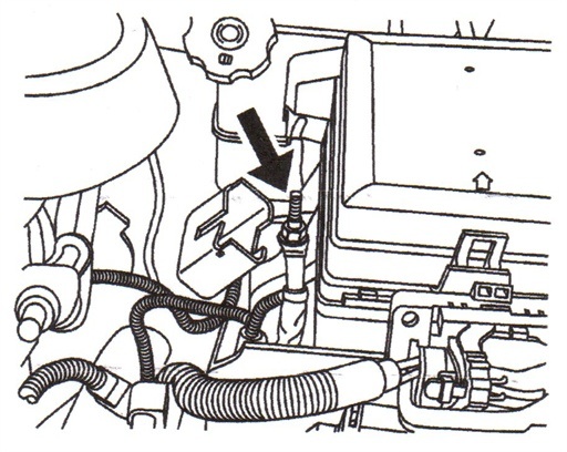

My car did this same thing it was a loose connection to the under hood fuse box as stated above. Here is the cable that was loose on mine.
