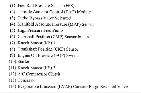

I've cleared the code a few times. I get the "check gas cap" warning now. With no check engine light.
But the knock sensors keeps popping up. I noticed rockauto has it listed under exhaust emissions etc...I am going to swap it out.
This would be located at #11 correct?

Originally Posted by donbrew
#11 on this
I assume bank 2 just means position 2 then?

There is no bank 2 on a HHR.
That's just the stupid generic message from the reader. As we know P0332 means low voltage at knock sensor #2. I didn't know which one is which.
