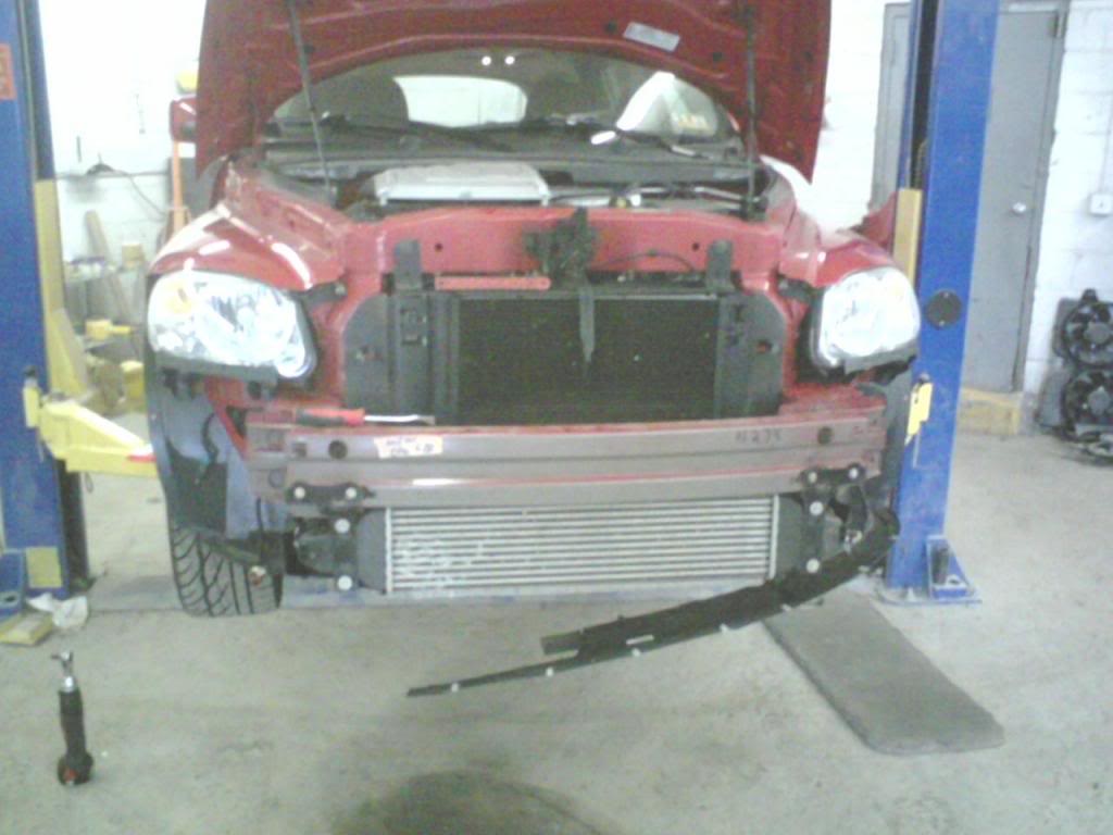

thanks Bart
yea the Werks mounts right to the factory mounting bracket. i'd highly suggest taking off the bumper, makes installation soooooo much easier.

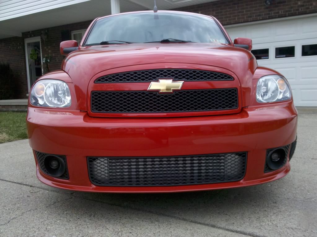

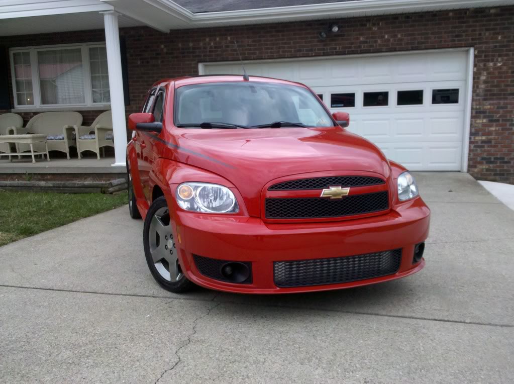

Dejon intercooler pics!
From what I have read, Dejon, Werks, and Hahn are the only ones that mount just like the factory one. You have seen the Werks pics posted in this thread, so here is the Dejon...

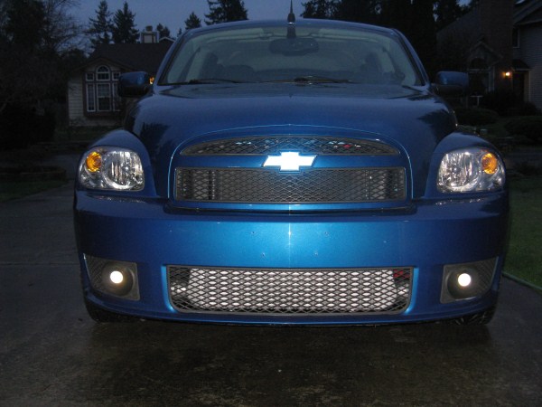

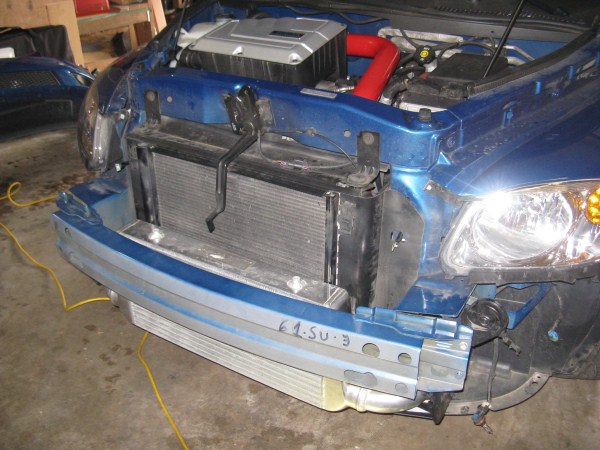

Or you can go insane big like I did with SSA:::::::::::::::::::::::::::::::

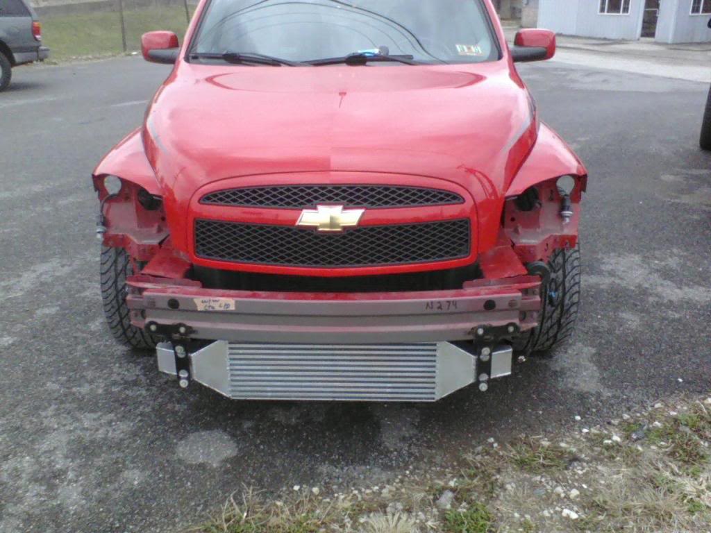

  #28
or this
