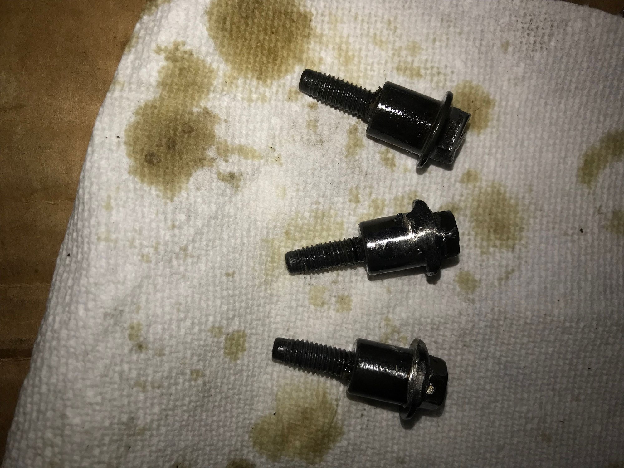

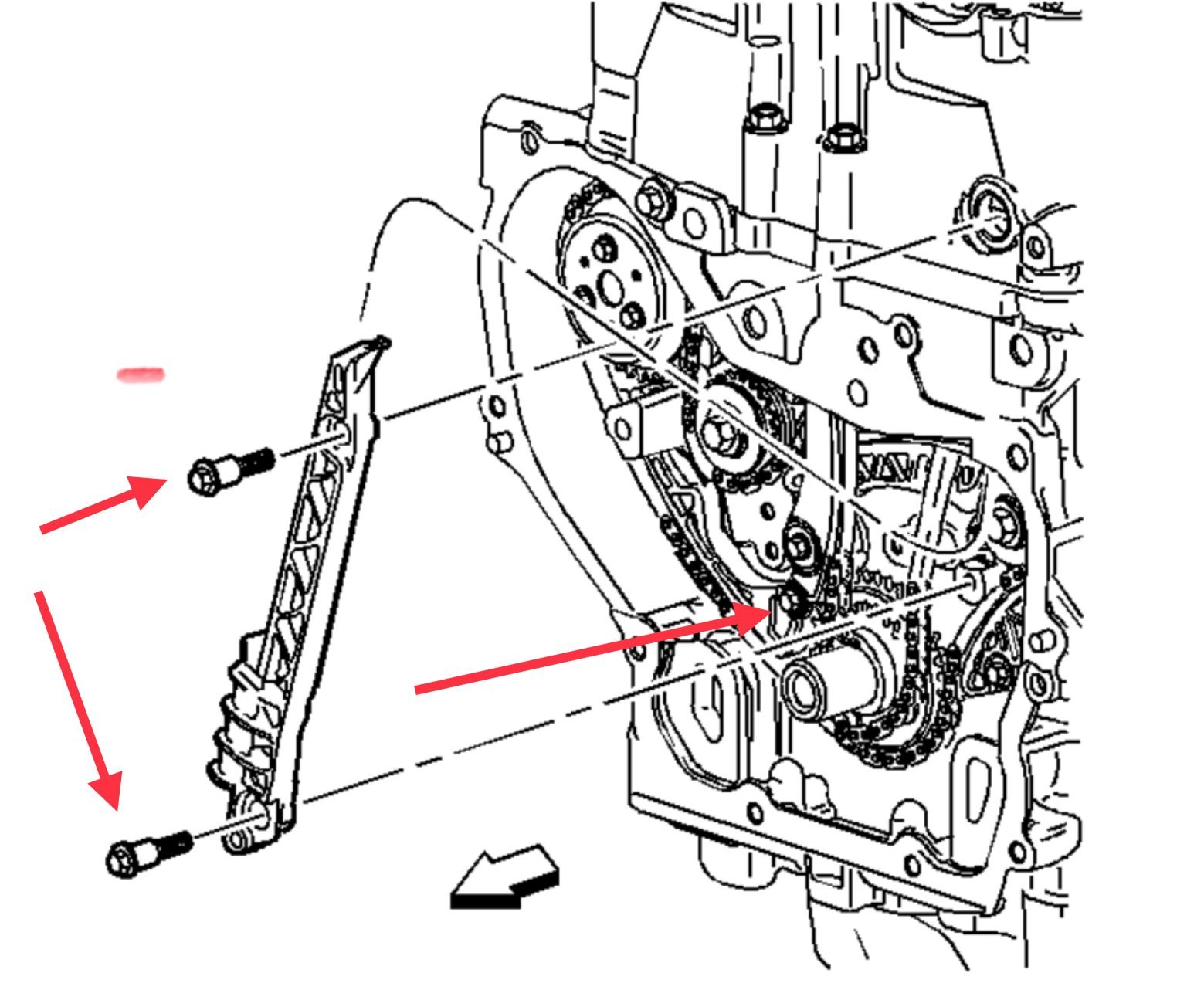

2008 HHR SS 2.0. I need part numbers for the two timing chain guide bolts and the balance chain guide bolt. They look identical, yet dealership is giving me different part numbers. 11588522 & 11518828

The front guide upper bolt is replaced by one of these
https://www.rockauto.com/en/catalog/...ide+bolt,12016
Improved guide and a new bolt for the bottom
https://zzperformance.com/products/z...ng-chain-guide
Like this
https://zzperformance.com/products/z...ain-guide-bolt
Old Feb 3, 2025 | 01:10 PM
Posts: 26,533
They don't look identical to me. The one on the top has a thinner washer/shoulder.

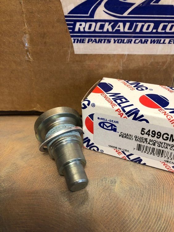

The holes are pilot drilled at the same time then C&C machined to specifications, no reason to think that they are going to be out of whack. I’ve installed several from different manufacturers and had no issues
This Melling bolt has been in the BlackSwan for two timing chain sets since 2019. Has 125,000 miles on it ! I also installed the ZZP front guide last timing chain set and it has  45,000 miles on it , no issues.
