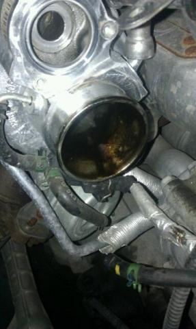

This is the picture he sent me...
Old Dec 8, 2012 | 10:46 AM
XtremeSS's Avatar
Joined: 02-13-2010
Posts: 698
From: HuskerNation
Wowza. That looks like a lot of oil. Why not take car to dealership? They usually don't look for tune unless they have to do extensive engine work. Turbo replacement is a 3 hr job according to gm which I wouldn't consider extensive.
