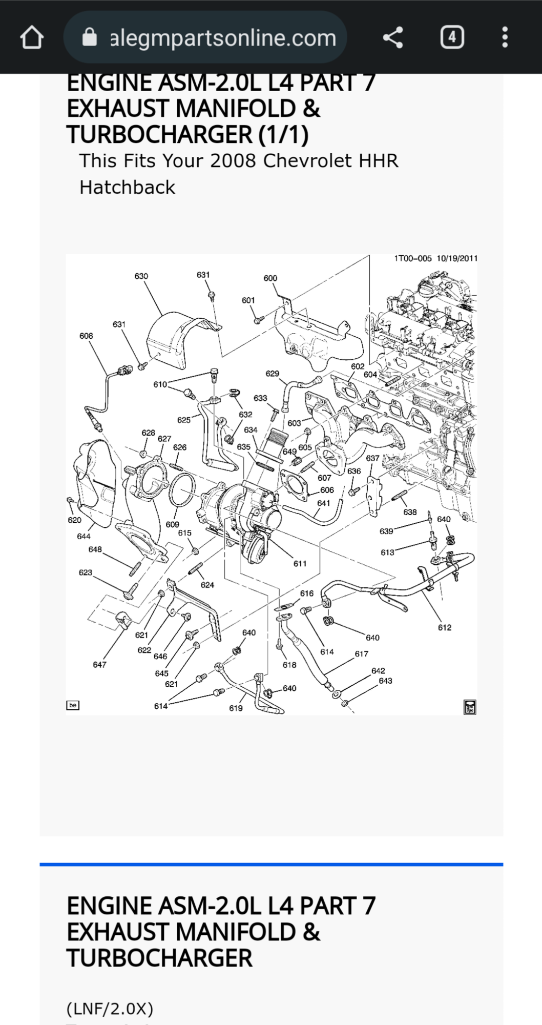

Here are the oil system gaskets.

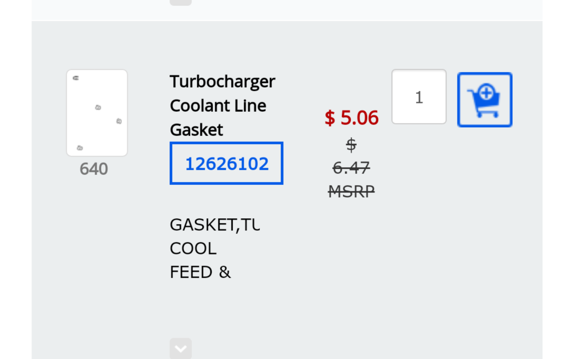

Coolant system gaskets.

Exhaust system gaskets. As you can see, there's no listing for gasket #606. Chances are, you can reuse all the existing gaskets, from all 3 systems. But it's up to you what to replace with new.
