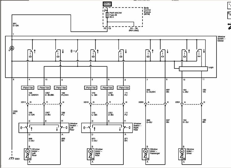

Seen a couple threads went through everything I could think of.... Both 30 amp fuses are good and the 2amp fuse is good also the 50amp fuse by the batter my is good... Windows won't work the window lock button light up on and then goes off when off Windows won't work in either from master switch or each individual switches... I replaced the master switch and still no fix... I don't know what else to check... Please help !!!!

Power goes from the BCM fuse to the drivers door master switch, from there to the other doors. Ground wire point for that feed should be under the drivers seat.
You said you replaced the master switch and that did not work ? I would assume you checked the old one for power with a test light or multi-meter ?
Or did you just throw in a new switch hoping that would fix it.
I would suggest checking the switch wiring plug for power and ground continuity.

So just pulled the drivers seat out ground is still connected tight ! I tried the master switch even though I saw power and ground from each button and saw them switch pos to neg... So if the switch is good fuses are good ground is good it's either all the motors went out at the same time or... The bcm has a issue right ? What else could it be ?

Post #7 says the ground wire is connected tight. But, did you test the ground at the master switch ?
What I mean is, did you test the wire for continuity at the switch ? Just because it's connected under the seat doesn't mean it's grounding the switch.
Got to get out the multi-meter and do some actual testing.
