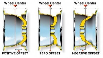

Old Apr 3, 2013 | 11:05 PM
Originally Posted by IHHRTHAT
No Brembos, and Quantum Tek ceased being a company some time ago so not alot of info on the rims.
I'd actually like to go taller not skinnier, and figured since 18/45 is stock, going to a 17/50 would work out to be similar enough in size.
I would like to go as wide as I can with them (225?)
You could measure the offset.. It's not hard (see pic).
Offset is measured from the rim center (width-wise) to the mounting flange..
The greater the number, the more the rim will set further inward..
Stock offset is + 42mm, or in inches = 1.653 inches.
Tallest tire would be not much taller than 26" to be safe imo.. The front strut plate is the limiter..
I got 225's on mine.. No problems. Lots of room...
