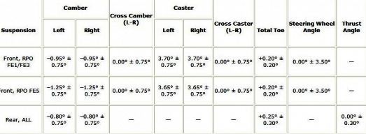

Once again, you're using a wrong number. We're talking degrees. A .17 would be, well, next to nothing, and well within specs.
Here. Take a look at the alignment specs. If you don't understand how to read them, then just leave it up to your alignment shop.
Believe me. If anything was out of spec., I'm SURE the alignment shop would try to sell you on a fix. That's how they make money.

Thanks George I understand now and yes it is .17 total toe and the specs are .03 to .28 degrees so anywhere outside of the range then there is a problem .. The only reason for concern was the number was in red is which threw me off on the alignment sheet .. But thanks for schooling me

Sorry, I misunderstood since now for the 1st time you say it's the toe on the rear wheels. I just assumed we were talking camber.
Here's some specs from my last alignment:
Left rear toe: 0.18 degrees
Right rear toe: 0.14 degrees
Total toe : 0.32 degrees
These toe specs show up green on my sheet.
