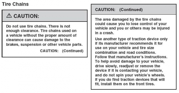

It's not an absolute, just a caution. Be careful and reminded --from a 2007 owners manual:
