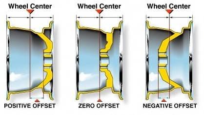

I'd be sure the off-set can be used on the hhr first.. Adding a spacer is not a biggie. But you don't want the tires slightly outside the fenders..

A spacer is one thing, because it can be of varying size. Typically, bolt pattern adapters are about an inch thick because they will essentially bolt on using your existing lugs/nuts...and have an alternate set with a different pattern. Therefore, your instantly one inch further out with the same offset due to the bolt pattern adapter.
You can measure the wheel from the mounting surface to the front lip, and then add the extra width of the adapter. Now measure that distance from the hub surface and that will be approximately how far it would stick out.
Hope that helps, what's the offset on the wheels your considering using?
