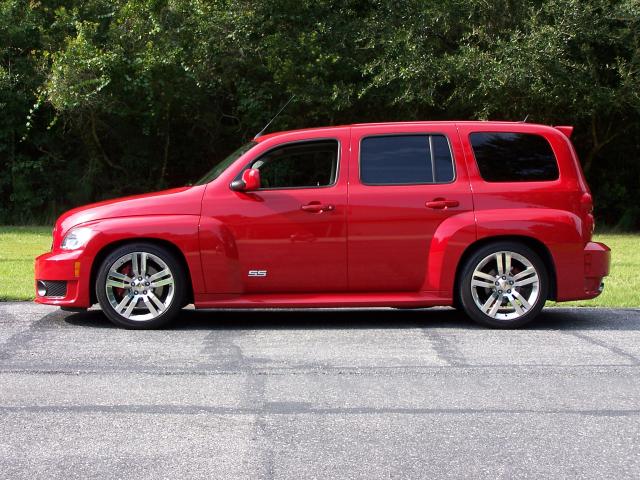

Rim size has nothing to do with the gap. If the overall tire diameter, a.k.a. height of tire, is the same/similar to whatever as already on the car then the gap will remain the same. 215/55/16's vs 225/30/20's are almost the exact same diameter and end up with the same size gap for example. This is because both tires have a diameter of roughly 25.5". If you use an 18" tire that is 26.1" diameter then it will have a tiny tiny bit less gap but it will be hardly noticeable as it amounts to only 1/4" less gap.
FWIW the pic in my sig is my car with SS springs and 20" tires in the size listed above.

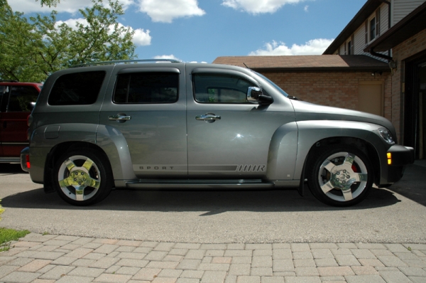

I have 17" Cobalt SS rims with Cobalt SS rear springs which may give you an idea on the stance. Hope this helps.
https://www.chevyhhr.net/gallery/fil...ne6_315667.jpg
