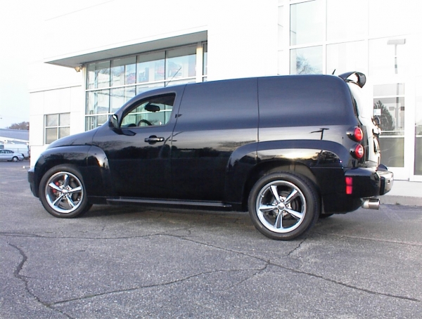

Hi All ,
Local guy has a set of Enkei 17" w/ 225-55 tires off a G6 . They'd look pretty 'Charp ' on me panel . $300
Don't think they have the air sensors . Do I really need them ?
Will the tires fit ? They got 30k on them but still have decent tread .
Comments ?
TIA
