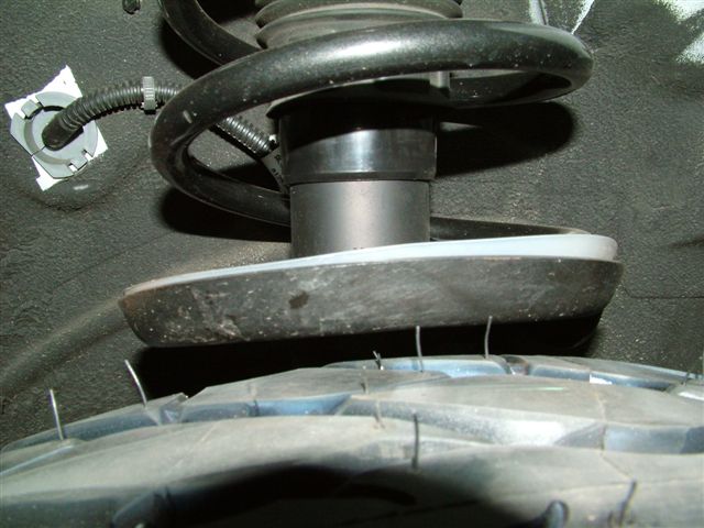

The bottom spring retainer plate on the strut actually hangs over the tire. If you go too large with the tires, it will rub on the bottom of the spring plate.
EDIT: heres a pic from another member, these are 25.78", so it looks like anything over 26" wont fit at all. It also depends on what your driving conditions are. Being in the snowy north, I would keep a good clearance.

unless you cut all the tread off of the inside of the tire i doubt it will work. tires werent too much for mine and iff the old ones are in decent shape they may be worth something.
