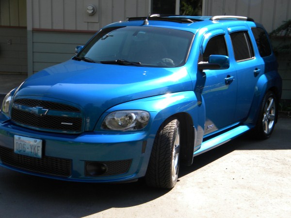

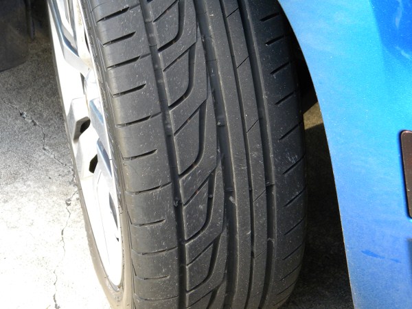

This was a changed I did recently going from a 225/45 to a 245/40 on a 7" rim. The 245 is only slightly shorter. I like the 245 much better......

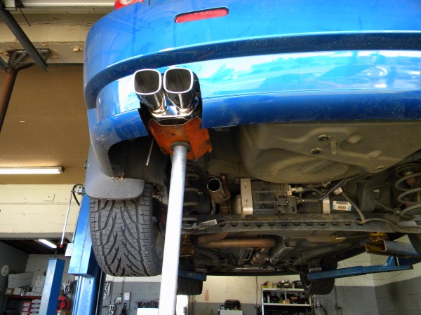

Tried them, like these better.
