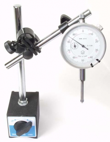

Sorry...but I need to be educated here...what is a 'dial indicator'? (I'm probably the only person who doesn't know, but I had to ask.)

FWIW:
Here's a shot of a magnetic base dial indicator. On steel hoop rims they tend to have a bit more 'run-out' than a cast rim since a cast rim is finished by machining it.
I generally lay a piece of steel by the (off the ground wheel) & set the mag base on the steel, & place the indicator tip on the rim edge & zero out the gage, then slowly rotate the rim to see how much 'run-out' it has..This is measured in thousandths..
With this both Radial & Lateral 'run-out' can be checked..
This is only something to do if you are experiencing balance problems..

Thank you. I appreciate it.
