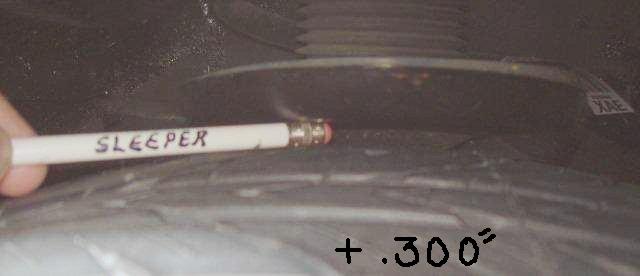

Old Feb 25, 2015 | 01:06 AM
Here's a shot of mine with 26.1" tall tires. (your results may vary), & as FMG posted tire shape / brand / etc can be different.
