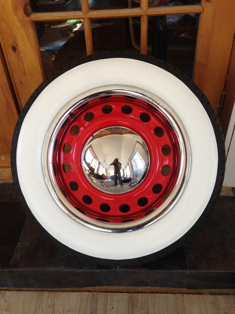

This is Plastidip rubber paint with vinyl paint over. Last year i made 2'' and this year i have 3'' white walls with a bigger tire (215-60-16). Never found a company that sells 3'' in 16 size tires so i decided to make them again for this summer. It take me 30 minutes to make one and i just repaint them once a month.

Neat! Keep us posted for any problems, like yellowing, peeling stuff like that.
Thanks for at least trying it!

Well i did this all summer long last year so here's what happenned.
The plasti dip flexes and holds great but yellows after about a month so you have to sand down the rubber then clean it a few times with acetone. Then i noticed that aplying a coat of white vinyl paint over the plasti dip it stayed white. It never peeled in 5 months and i drive my van daily.
