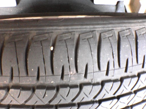

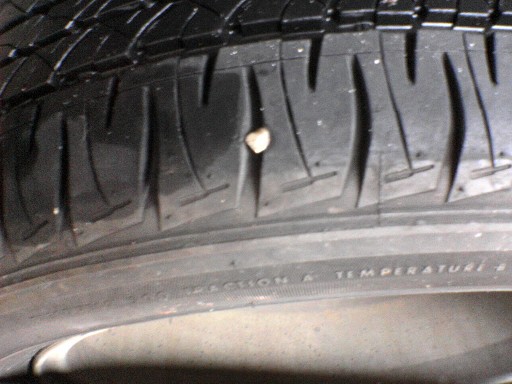

I went to have the slow leak in my tire looked at and found not one, but two nails. The tech at Wal-Mart told me they were too close to the side wall and could not be repaired. The patch could damage the side wall and cause a blowout. Do you guys agree? The tire only has 20,000 miles on it. Can a tube be installed? If not, I guess I'll replace all four since the stock tires aren't the best available.
The top one looks too close to the sidewall, but I could be wrong. The bottom one looks like a rock, this I could be wrong about also. If you tried to fix the one in the top picture, it may not hold due to the natural rolling of the tire edge during turns. If enough air escapes before you realize it is leaking, the side wall would overheat making a blow out possible. I would replace it. A tube is not a viable option either IMO.
check out this http://www.dunloptires.com/care/repair.html it shows area of a tire that can be repaired. Hope it helps. Have to remember, your life depends on condition of your tires.
I have repaired more than 200 tires back in my days...
both could have been repaired....IF...they were not in the same tire.
Putting a radial patch in a tire is no problem, if they are within the tread cap area. Many tire manufactures use a molded line inside the tire to indicate the tread cap area.
But you never want to have TWO patches in one tire.
lastly...do NOT put a tube inside a wheel/tire that are not designed for tubes.
replace the tire.

We have the Firestone/Ford fiasco to thatnk for that. Since all that, NHTSA, UTQG, RMA, and tire makers have gone back to the drawing boards and decided what is safe and what is not. Certainly that tire COULD be repaired safely and probably with no problems EVER. Problem is RMA has set guidlines for tire repair facilities to go by. If the repaired tire does fail and all of the guidlines where in fact followed, there would be no repercussions on that facility. Think that sucks. Check out what Michelin has to say about where to put your new tires when replacing only two http://www.michelinman.com/tire-care/how-to-buy/
