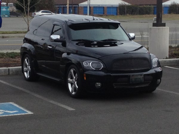

Old Mar 25, 2013 | 09:35 PM

i want to go 18's ..and ya i was a little skeptical about it being a 35 series, going to be like riding in a hummer lol
so whats a good size to go 18" from my stock 16" and not screw up the speedo readings?
