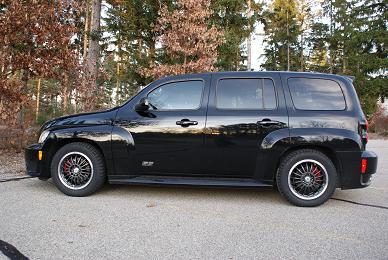

The 16's will be fine on the SS (without brembo's) I ran these 16" Enkei's with 225/55 R16 Blizzacks
You will LOVE them in the snow!
