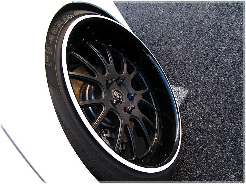

why would you put such a skinny tire on a 8.5" rim. I have 245s on a 8"
prod 03-29-2011 10:11 AM
1 Attachment(s)
Thats the fashion now, stretched tires on wide rims.
Attachment 29491
