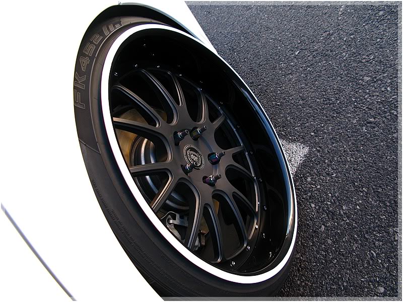

Originally Posted by bartSS
why would you put such a skinny tire on a 8.5" rim. I have 245s on a 8"
Thats the fashion now, stretched tires on wide rims.
