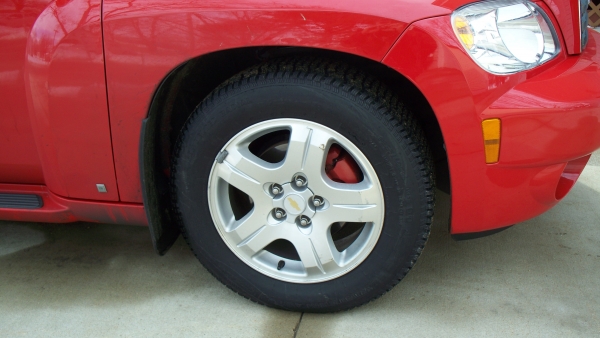

I am running 225/60/65 studded snows on Malibu wheels. They pull pretty good. Plenty clearence for me on the front. Rear is tight but don't rub. 12-14inches snow today. The "Red Toad" stayed in the garage. Got the Silverado out.
