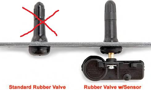

I don't see why you can't just do the air down till beep, like the owners manual describes.
But you would need to do this AWAY from the old wheels, since the car does not know the wheels are not connected to your ride anymore..And will still read the old sensors..
Personally, I'd have just used the OE sensors you have in 16'ers.. All you would'a needed was new valve stems, they have a small screw that holds on the sensor.. (see pic)..
