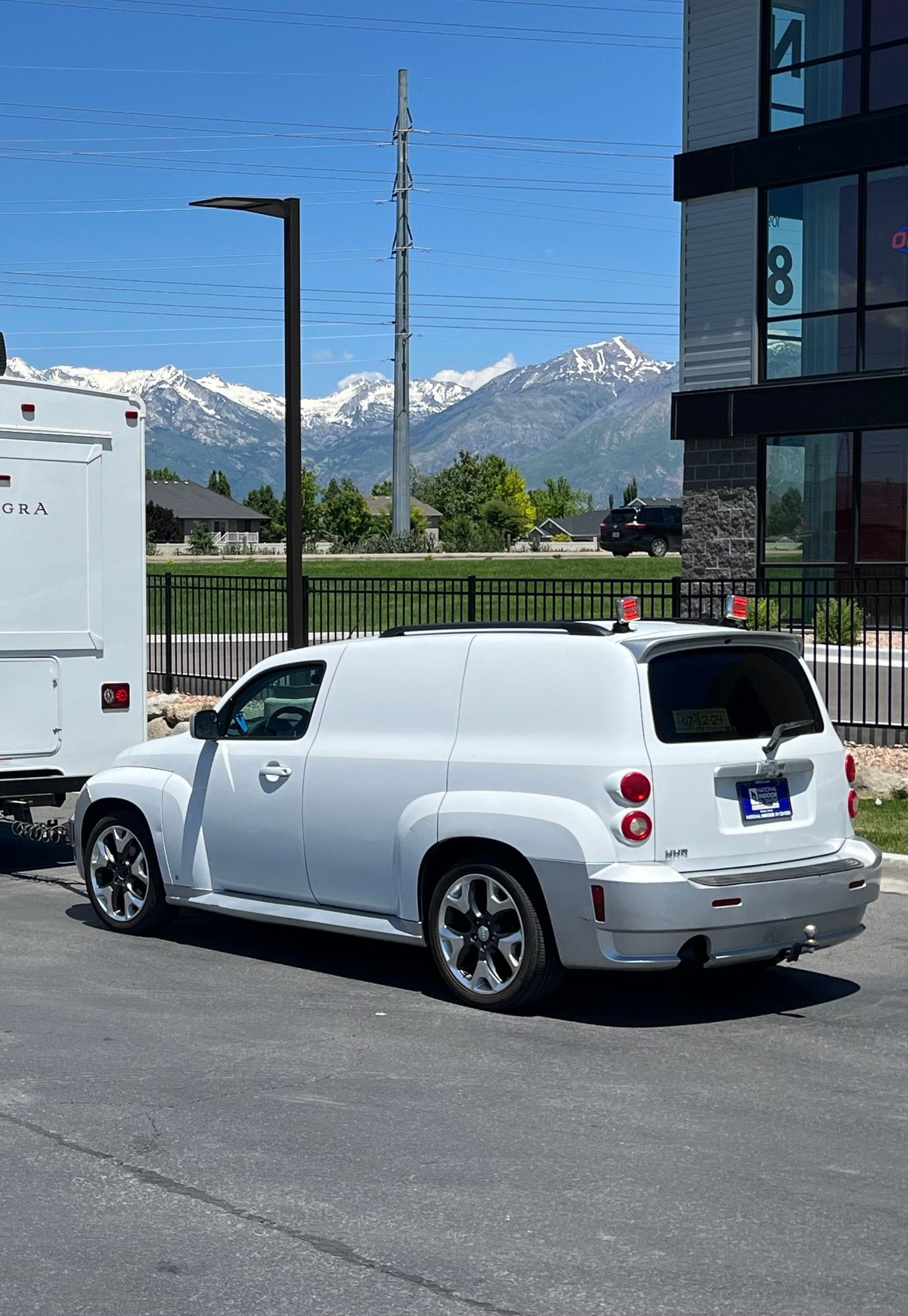

I'm running Jeep Compass 18" wheels on my 08 HHR panel. They are the same bolt pattern and the offset is very close, if not spot on. They look great and it gives it a more custom look
post some pics... I've looked at Jeep rims before, but I've debated if I'd like them once they were on the car

Jeep Compass 18” wheels
Obviously taste is soooooo subjective, especially when it comes to wheels and other styling things. These were added by the previous owner and I liked them so I kept ‘em.
