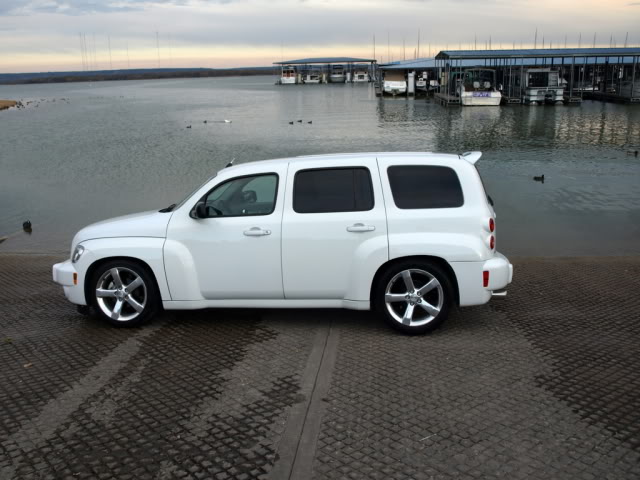

I have the Pontiac Solstice wheels
I have the Pontiac Solstice wheels and the Saturn Sky wheels will also fit.
