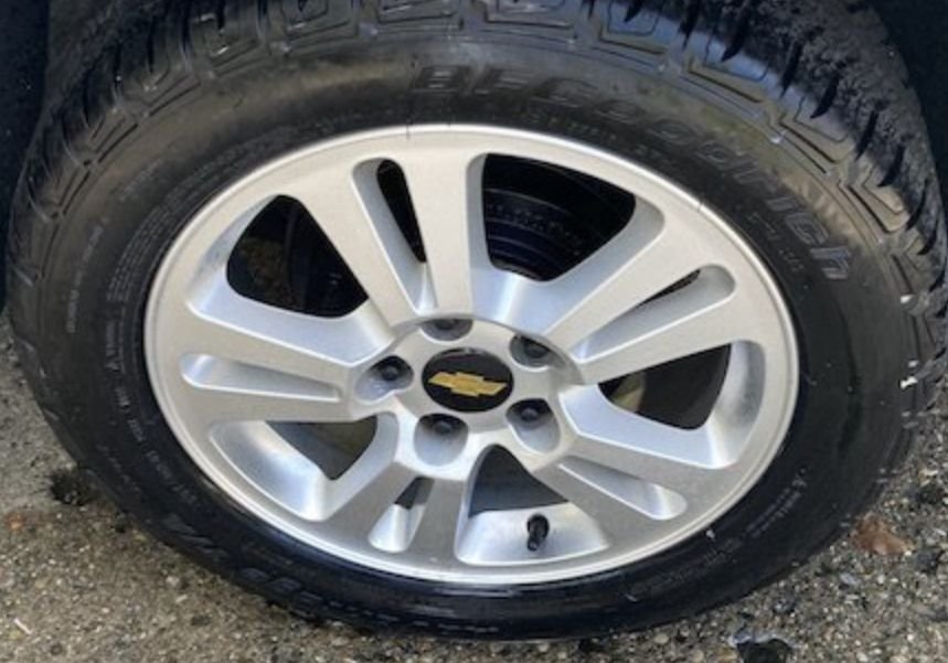

Originally Posted by Cheap Guy
These wheels came off of a 2006 Saab 9-3. Fit perfectly, no issues. Whether they look right on a HHR is your opinion. I'm kinda mixed on the look.
Those are very appropriate, a good nod to the HHR Art Deco connection, as the HHR SS. Cobalt LNF wheels kinda work out that way too.

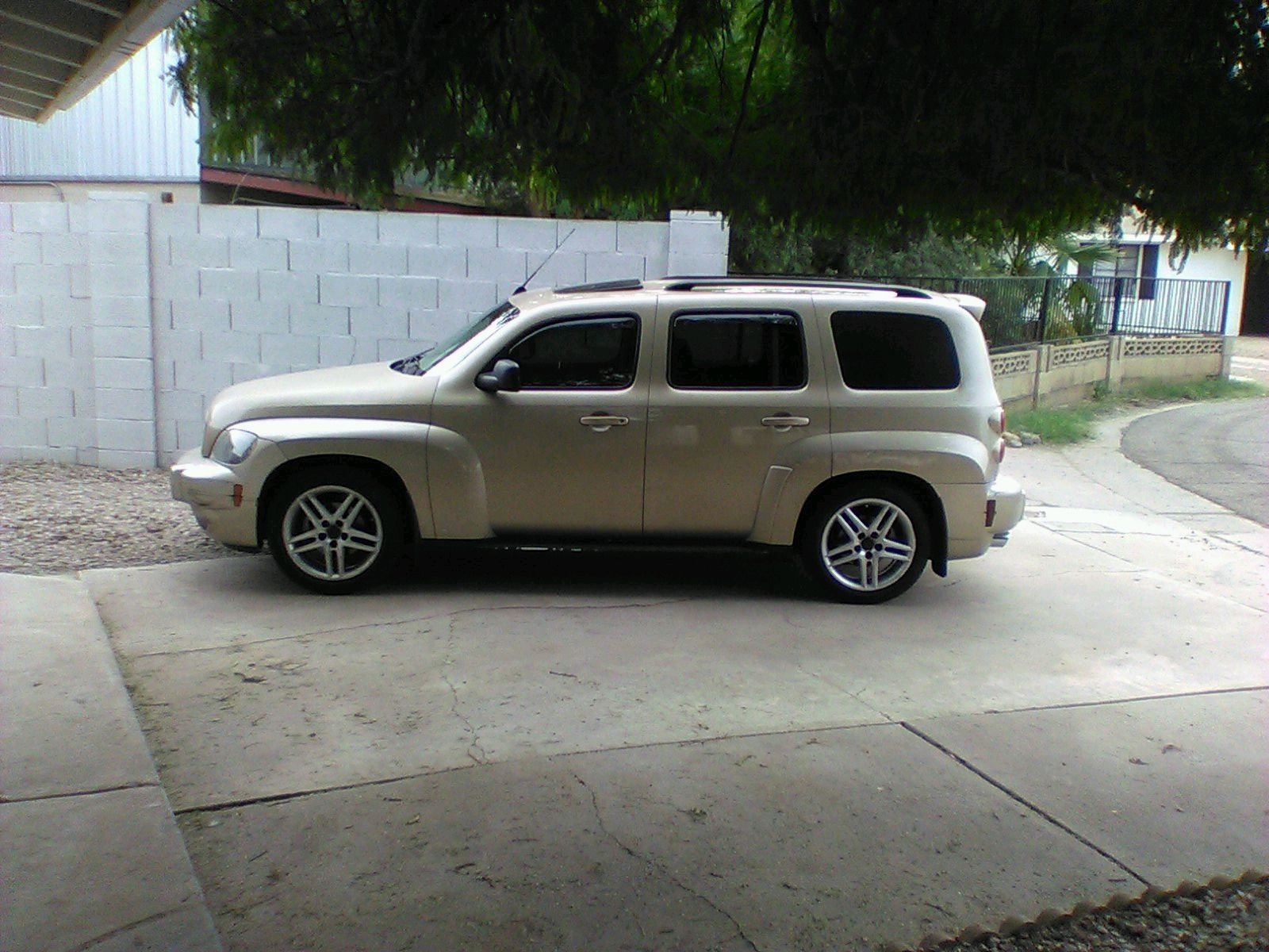

These 17 X 7.5 came off a 06-07 Saab 9-3. Only made for 2 years. I like em.
Man, your car is almost perfect to me - the sunroof, the black trim, the SS spoiler, even the splash guards - it's exactly how I'd have my car if I start over again. The Saab wheels are right on - I think 16" and 17" are perfect for these cars.
