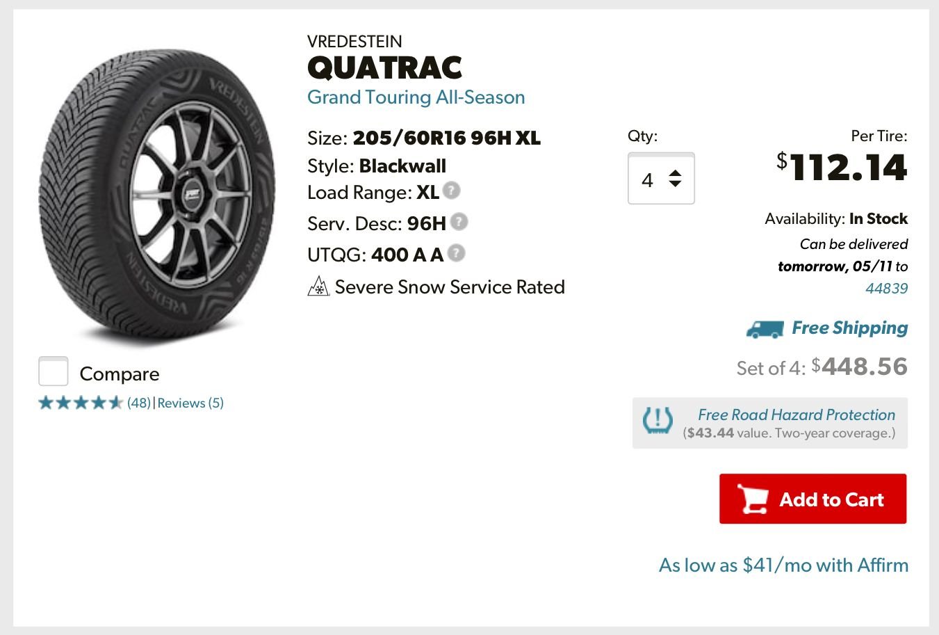

On two different LS’s I’ve used Pirelli P4 205/60 16 based in part on a closeout price. Just a little narrower and taller than the factory 215/55 16. They work well, but the tire brand and model is much more important that subtle differences in size.
I like to use the Tire Rack site for shopping because it works so well even if I end up buying elsewhere.
If I were buying that size today, I might try these becaue my wife places a high value on snow performance and these look like a super deal. But XL tires tend to have stiffer sidewalls which can make the ride a little firmer.
